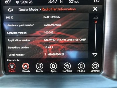

It appears that the update was already completed...version 16.44...oh well off to the dealer it goes i guess...(downloaded the update and put it in USB port and nothing happened what-so-ever anyhow)...dont let phone icon fool you no phone paired...lol
Well at least you know it’s not the software version.
