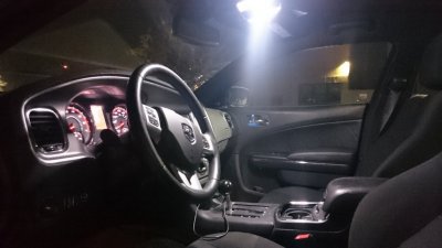

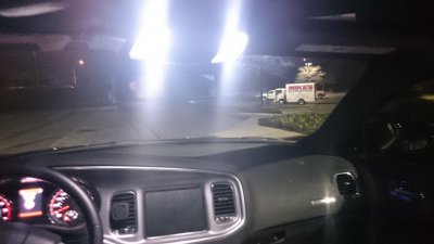

    cool white.
    I will be doing some interior Lighting also. When I get a good complete list of bulbs It will get stickied

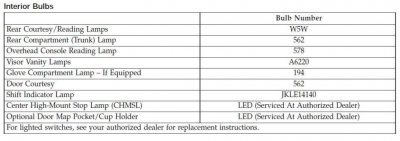

    that'll be good. i still gotta do the trunk and puddles.
    Here is what I Have so far
    Trunk - 561 two needed
    Puddle Lights 561 four needed
    Rear Reading lights 194 two needed
    Glove box 194 one needed
    Map Lights 578 two needed
    dome lights 578 two needed
    48
    thats for ours. Jimi Doesn't have map lights. his overhead looks different
