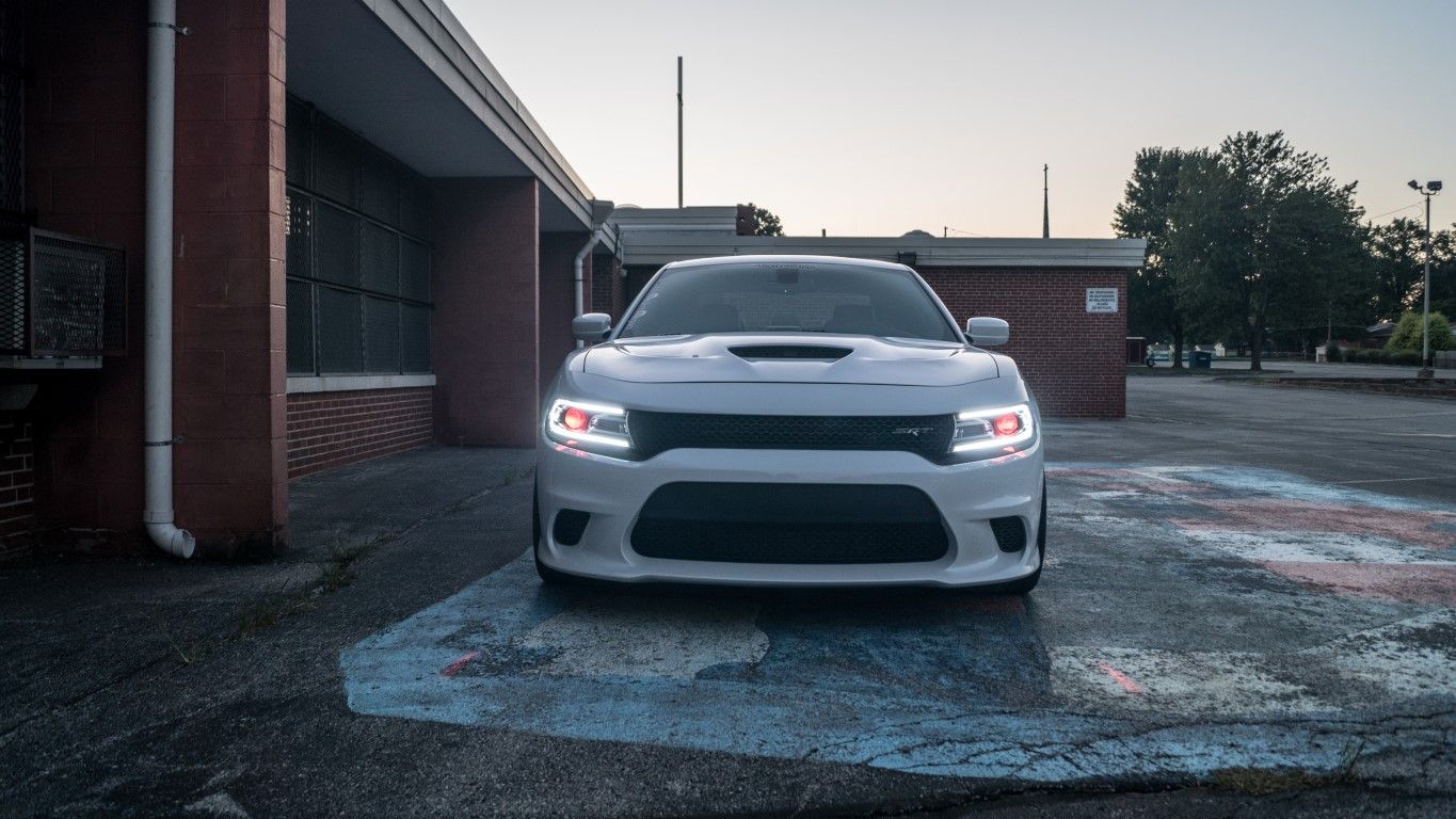

    She got her new eyes [​IMG][​IMG]
    These are installed on our "shop" Hellcat - our show car to feature our lights (here at RetroShop). These where dual color painted (satin black and Ivory Pearl), DODGE letters shaved and the '17 Hellcat logo vinyl'd in and we etched the lenses with the Hellcat logo and my company's name. From there, we are running a few new things in production from Diode Dynamics. We have the first set of aluminum based DRL boards in here, which run approx 5x brighter than the current DRL boards - and.....we have 2 sets of their upcoming "pro series" demon eyes.
    Also, a few of the install pics.......kinda showing my anal retentiveness coming through........its incredibly hard to see a wire on this setup, even though I have 4 bluetooth controllers, 4 LED drivers and a full relay harness running these.

    nice. Lots of wires to tap in.
    Beautiful. I loved the etched ptojector. And amazing job on the install

    Fantastic setup!

    I mean... They're ok I guess. :jawdrop:
    Seriously, those housings are the seks.

    Very nice touch, excellent install, shows class not overdone and care taken.
