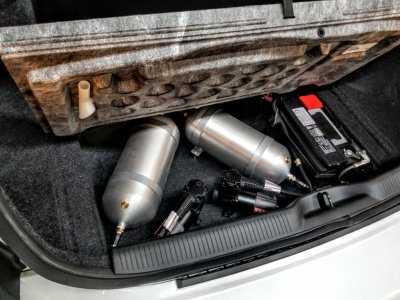

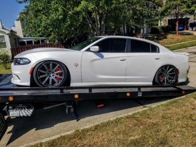

Try to start.....nothing. Crank and crank. Tried to jump....nope. Load it up. Fun, with the bags on it lol. We raised it up to load, then we lowered it so we weren't compressing the bags.

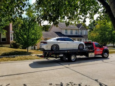

Called for roadside assistance Monday morning. What a clusterfuck. 645AM, off the phone. 749ETA of tow truck. At 810, they called (Chrysler, automated system) - asked if they where there......nope.....got transferred to the tow truck place. They are running behind (duh?). I ended up calling them multiple times, and they "cancelled" me. Idiots......had to call another truck, this one showed up 40 minutes later (at 1215PM)
New driver gets in the car, unsets the ebrake......boom - lights come on.
Try to start.....nothing. Crank and crank. Tried to jump....nope. Load it up. Fun, with the bags on it lol. We raised it up to load, then we lowered it so we weren't compressing the bags.By the time it got to the dealer it was way late, and they didn't have a tech to work on it. Funny, my uncle works there, he was assigned the ticket

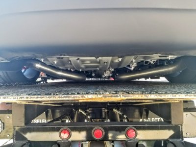

On a side note, I could finally see how low this thing is.......eek!
