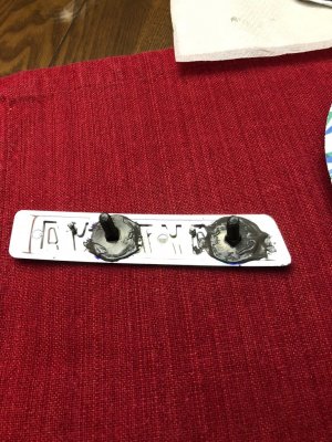

    Last night I stared on my modification for mounting the DAYTONA badge to the new grille. I went to lowes and got (2) 1" long 1/4x20 elevator bolts and (2) 1/4x20 locking nuts.
    After finding where I wanted the badge to mount I taped it in place so i could see where the elevator bolts needed to be attached to the badge from behind the grill. A little JB weld and I now have a badge with two threaded posts.
