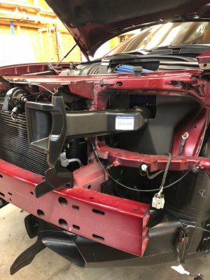

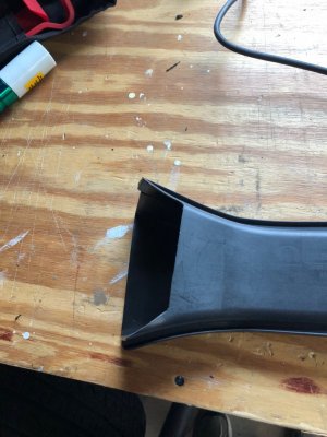

since I'm doing the 2019 grille swap I also swapped to the new air intake part # 68394595AA Since I already had an intake tube/duct I wasn’t buying the new one since it is an easy modification to make it fit on the new shield.

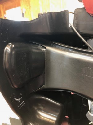

Here is what the intake tube looks like after being cut to fit the new shield
this is the back side of the shield to show how the modified tube fits

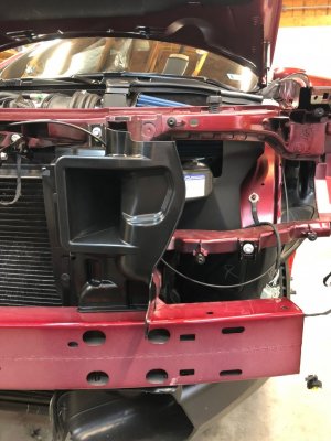

and just pics of the new shield and tube back on the car

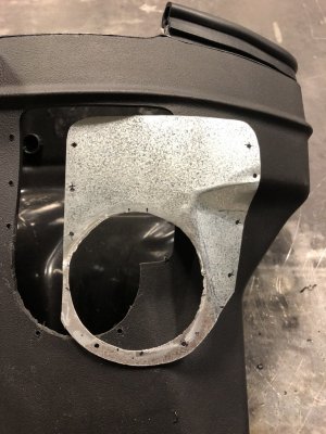

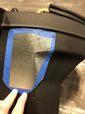

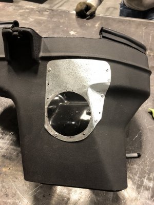

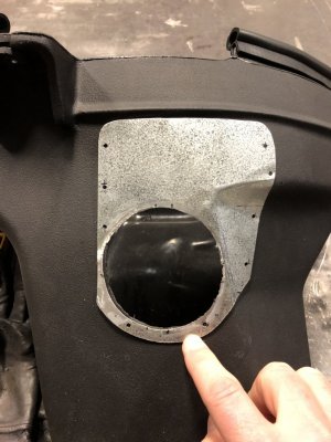

Here is a little preview of the piece that will be used to seal off the opening in the air box
